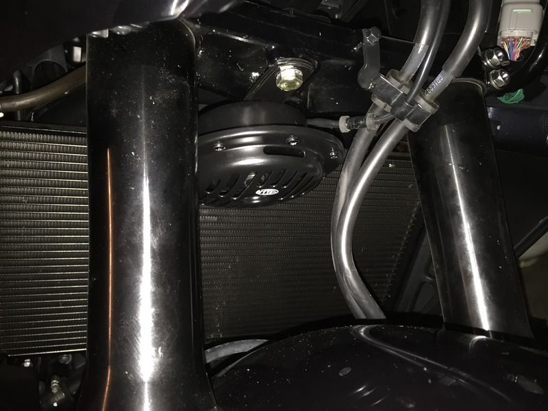

I've had Stebel Nautilus horns on past bikes, so I'm a believer in changing the horn to something more attention grabbing. I've had a WOLO Loud One low tone from an auto parts store under there on the CTX, and although it never hit the fender, I felt it would if I bottomed out. Sounded pretty good, like a car horn. Just a disc horn with a plastic trumpet
I ordered a Hella Supertone from Amazon for $31. Much bigger and heavier than I thought it would be. No plastic in this thing. Bracket is tripled though so nice and sturdy. Clearance is much better and I don't think it will ever hit the fender. It sits further back, nearly touching the radiator. Only thing had to do was pull the horn wire out of the retainer for some more length and rotate the terminals some on the horn so the connections reach. This thing sounds awesome and it's very loud. Highly recommend this to anyone looking to replace the meep... meep... stock horn. Mark
