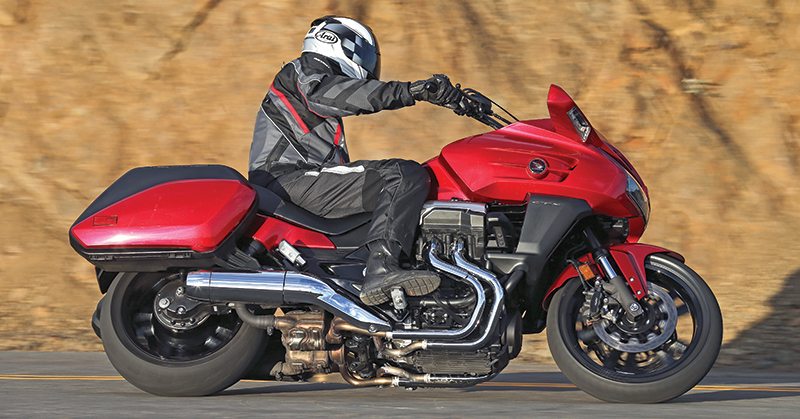

The promo photo shows what my problem is.
The rider's shin is going to clobber that valve cover as soon as he presses his right foot forward into the brake peddle:

Sounds like the real issue is that the brake pedal needs adjusting for you. My legs look like that picture but it's really just my riding pants being baggy. I can scoot forward and touch the covers just below my knee if I really wanted to, but I like to set back in the seat. I don't ever have an issue with with my leg hitting the cover when using the rear brake. When I push on the brake my leg doesn't move forward at all, just my toe goes down. Sounds like the pedal is too low for you. I would think you could adjust the pedal up a bit and resolve the issue for you easily. It is at least a little bit adjustable.
Note: if you have the service manual the brake pedal adjustment is described on page 3-17.
